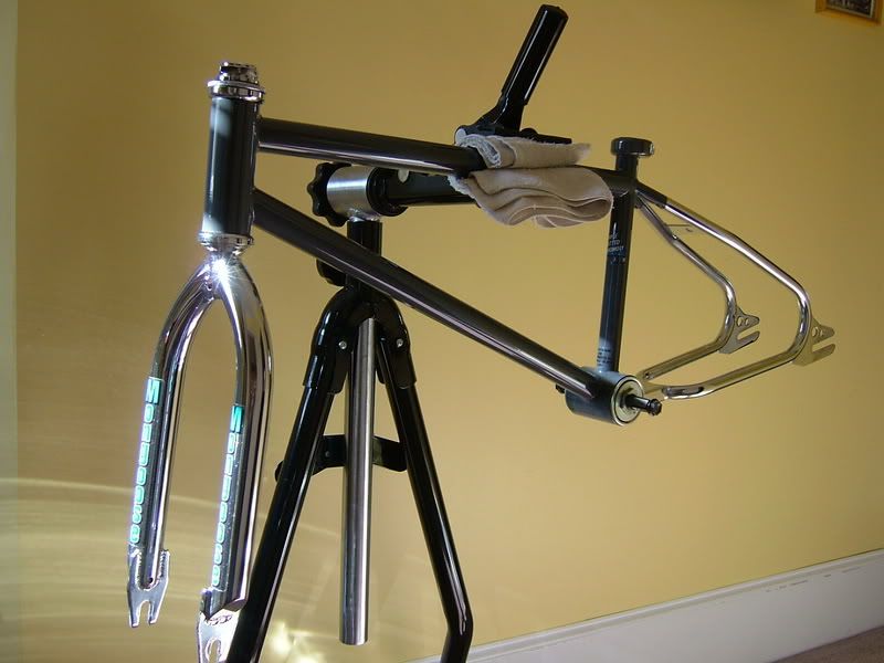

20 June 2009 - 09:07 PM Post #19
  • Posts: 2024
  • Joined: 11-June 06
I did both of these with the spray on paint stripper and then had them powdered. They turned out fine.Attached ImageAttached Image[attachment=7
