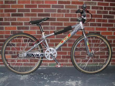

I believe that frame was recalled by GT because the frames snapped at the head tube. We (Kovachi Wheels team) had all of our 1996 Speed Series frames replaced with Box Series frames during the recall.
This was the frame they replaced the '96 Speed Series with. I think I would retire that frame.
Richard Vogt
bmxmountainbiker
You're right, that frame was recalled. I had my original replaced with a 98 Box frame, but I missed the 96 enough to buy another. The frame cracking at the headtube is yet another reason I'm thinking I shouldn't be riding it much anymore.

Tough call, I have a recall xxl that I ride pretty frequently, but most certainly do not thrash on it. I also have the recall cruiser frameset for wall art. I would say for normal leisurely cruising it would be fine. If you do decide to retire it, retiring as it sits would be cool, broken crank and all.
Nice Box Richard...errrr...:lol: Do you still have that?
