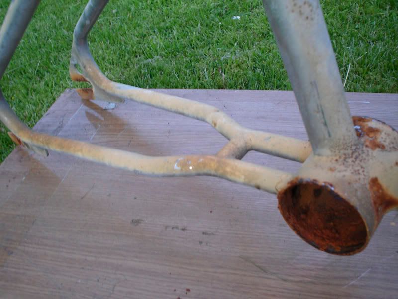

    I found this JMC DY frame with Bottema Race Forks in an old friends dark damp cellar. It was resting on its rear drop outs with the forks against the wall above a ventilation grate. The ventilation grate was letting in a supply of damp air in across the f&f causing a fan of rust and corrosion across the down tube to the seat tube, top tube, bottom bracket and both seat and chainstays. It was a dirty mess for sure.
    As I found it in the cellar
    and out in the fresh air
    it cleaned up a little better though
    I was quite happy to keep it in its survivor condition but when I got lucky on a GT on eBay with DY forks and bars for peanuts the wheels started moving for the restoration. The bars and forks were not in great condition but nearly as bad as the frame. So the frame went to stripped, having the chroming process reversed. The forks and bars were stripped, polished and refinished.
    When the frame came back from being stripped it looked better without the rust for sure, but the time in the cellar had really taken its toll on the frame. With the damp air coming in over the frame it must have caused the metal tubes to 'sweat', with a build up of damp inside the frame it must have been rotting from the inside. The loopy rear end really took it badly. The loops must have acted like a 'U' bend on the toilet and held the moisture because it was littered with small holes in the tubing and the welds on the drop outs. Holes were found in the seat stays, chain stays and the odd on in the top tube.
    The first thing that Phil Sawzal did was to make a bath and submerge the frame in Hammerite rust eater. After a soaking in the bath the frame was jet washed thoughly, getting plenty of water running through the tubes and flushing them out before baking it to dry it out thoroughly.
    When the rust eater was drained from the bath quite a bit of rust and crap was left behind. It was going to be a gamble as to whether or not the tubes would have any thickness in them to weld to.
    A coat of primer was applied before flooding the frame with some rust neutralizer.
    Some of the holes can be seen in the following images.
    The problem areas where highlighted and carefully drilled out to remove any further rot around the hole. This would leave Phil something weldable!
    Using a both welding and plating methods Phil dug deep with his patiance and lucking the frame didnt fall apart. Some smoothing and building up of some weld brought the frame back to something like it should be.
