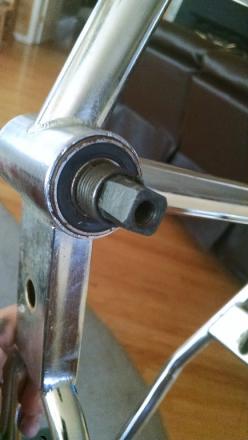

Chris Oakden Posted October 28, 2015 Share Posted October 28, 2015 I recently acquired this '79 Cook Bros frame/fork/BB set. I would like to know if anybody can ID the BB and is there a way to remove it without destroying it. The bearings have a few rough spots in them and I'd like to fix it. This is my first CBR with the euro BB and really want to make it right. Also looking for a decal set as well. Thanks! Quote Link to comment Share on other sites More sharing options...
RyanPartridge Posted October 28, 2015 Share Posted October 28, 2015 Some of the CBR frames came with a threaded Euro BB shell and some came with a "mini" press-fit shell. Your's looks like it could be a press-fit style but I'm not sure. 1 Quote Link to comment Share on other sites More sharing options...
markmc97225 Posted October 29, 2015 Share Posted October 29, 2015 My CBR Euro has a threaded, but, appears to be slightly machined down threads BB. I think they are all press fit in the end, but, maybe not. The bearing is an R10 sized bearing. The "cool" bearing to get is the R10 Snap ring bearing - this bearing has an external groove that a snap ring fits in, and keeps the bearing from sliding too far in. I think you just pick a side there and some sort of internal sleeve probably will knock the opposite side out. Or, if not, the full spindle will come out anyways, leaving you the ability to punch the bearings out with a press. Here's what that snap ring bearing looks like: Quote Link to comment Share on other sites More sharing options...
Chris Oakden Posted October 30, 2015 Author Share Posted October 30, 2015 Thanks for the responses. Any ideas which bb is in it now? Instead of normal spacers, there are springs on the spindle. Quote Link to comment Share on other sites More sharing options...
blikum Posted October 30, 2015 Share Posted October 30, 2015 Looks to be a press fit. I'd bet someone used those springs in lieu of a proper spacer. The bearings that Mark posted are more than likely what you'll need. Hard to know for sure until you remove the old ones. Post pics when you have them removed. Quote Link to comment Share on other sites More sharing options...

markmc97225 Posted November 6, 2015 Share Posted November 6, 2015 I know there are a lot of solutions on this one. The one thing I think is consistent is the bearing. R10. In the bearing world, that's the "base" info, which is the ID, OD, and thickness. R6 is the bearing for Sunshine hubs. R10 is CBR BB. Every other letter or digit is a feature ID. An R6RS is an R6 bearing with 1 Rubber Seal. Take an early Sunshine hub apart, many will not have an internal seal. An R62RS has 2 Rubber seals. Both sides. The snap ring I think is "NR" So, you could have an R102RSNR. There are things like ZZ and other letters which represent ceramic bearings, or high load or high RPM capability, or the seal material (metal, vs rubber). So, any R10 bearing should fit the hardware dimensions you have, but, I could see where a shorter spindle would have issues with a snap ring bearing perhaps. On a followup note, an "R" bearing is US/SAE measurements. A 6000, or 6200 bearing would be a metric sized bearing. Those are 2 sizes used commonly on Suzue sealed hubs. Sometimes, as you're trying to read old, dry, cracked seal covers, knowing if it's a "R" or an "8" can be helpful. Quote Link to comment Share on other sites More sharing options...
