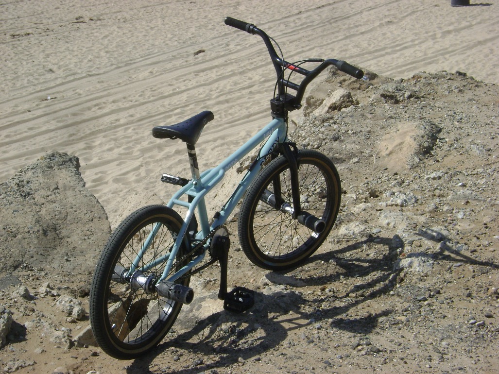

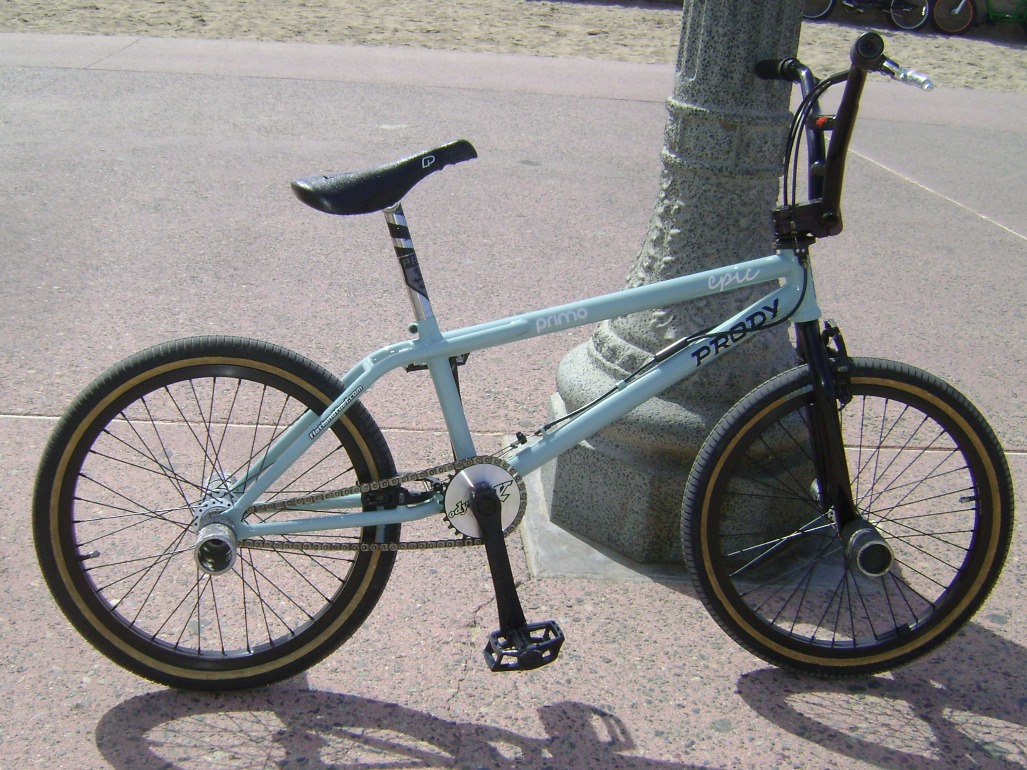

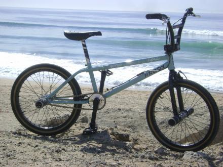

D MAN Posted February 25, 2016 Share Posted February 25, 2016 2016 Colony Prody The Prody frame is back again! The new 2016 Colony Prody frame mixes old school design with modern day geometry and materials. Made from 4130 chromoly tubing with a heat-treated integrated headtube drilled for gyro tabs, external headtube gusset, old school 80's standing platform on the toptube, tapered downtube, integrated seat post clamp, heat-treated Mid BB shell, tapered rear stays with room for large tire sizes, welded chainstay U-brake mounts with clearance for 25T sprockets and 5mm thick heat-treated dropouts. Headset Type: Integrated (Campy)Gyro Tabs: Removable (Included)Brake Mounts: Removable (Included)BB Type: MidBB Height: 11.5"Chainstay: 13.6" - 14.1"Headtube Angle: 75.2°Seattube Angle: 71°Seattube Height: 8.3" (210.8mm)Seat Post Size: 25.4mmSeat Clamp: IntegratedDropout Size: 14mmWeight: 5 lbs 12.1 oz 2016 Colony Prody My new rider I built up with the help of EPIC BMX bike shop frame is a 2016 Colony PRODY forks 2014 Primo with 990 ad mounts. head set Kink bikes integrated. Stem HB bikes bars Peregrine Q Bars Brake levers Dia-Compe MX99 Brakes Odyssey spring field. Gyro ODYSSEY front sprocket Odyssey 28 tooth anniversary CD. chain Shadow conspiracy half link cranks Alloy Primo hollow bites 175mm pedals Redline DX 9/16 wheels Revenge Industries 20" Double wall alloy 36 hole with black spokes laced to silver Revenge sealed bearing hubs. rear is alloy freecoaster with KHE guts tires Odyssey Frequency G 20X175 tubs nothing special. seat post Primo Rod micro ajust seat Power lite GT performer style bike looks Old School when it's really new School GEO with Old School STYLE looks! all most all parts can be bought of the shelf of most good bike shops. Quote Link to comment Share on other sites More sharing options...
Admin TrulyOdd Posted February 25, 2016 Admin Share Posted February 25, 2016 Nice. Are they considered a flatland frame? Let's see some tricks on it. Quote Link to comment Share on other sites More sharing options...
RL Paulie Posted February 25, 2016 Share Posted February 25, 2016 I like it. I looks kinda long for flatland specific but looks like a comfy cruiser/all around bike. I take it you don't do any bar hopping stuff or surfers. Quote Link to comment Share on other sites More sharing options...
D MAN Posted February 25, 2016 Author Share Posted February 25, 2016 Nice. Are they considered a flatland frame? Let's see some tricks on it. no more of a true freestyle frame. IE one you could ride street,ramp and trails with. but yes it can be set up for flatland to. Quote Link to comment Share on other sites More sharing options...
D MAN Posted February 25, 2016 Author Share Posted February 25, 2016 Nice. Are they considered a flatland frame? Let's see some tricks on it. yes it dose wind surfers. but I use it as a all around freestyle bike. not just flat. Quote Link to comment Share on other sites More sharing options...
Admin S.Brothers Posted February 26, 2016 Admin Share Posted February 26, 2016 looks like a good bike Quote Link to comment Share on other sites More sharing options...
D MAN Posted February 26, 2016 Author Share Posted February 26, 2016 looks like a good bike Thanks so far it rides grate for what little I can do with it. LOL mostly old tricks from the 80's. not to good at the new tricks yet. but I do try! Quote Link to comment Share on other sites More sharing options...
Admin TrulyOdd Posted February 27, 2016 Admin Share Posted February 27, 2016 What is the TT length? Quote Link to comment Share on other sites More sharing options...
D MAN Posted February 27, 2016 Author Share Posted February 27, 2016 What is the TT length? 19 Quote Link to comment Share on other sites More sharing options...
